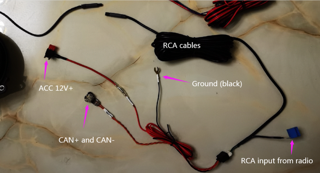

Tip: Before you install the camera, it is best not to bury the wires first. Install all the connections and plugs to the designated positions as shown in the picture, and then test whether you can get the reversing image. Then you remove the screws from the trunk to secure the camera and bury the cables.
1.Strictly follow the installation instructions and connect each wire correctly
2.Make sure activate the back-up camera function of the head unit
3.The trunk handle camera has the same connections No. 6-10. (For jetta 2011, Passat, Tiguan)

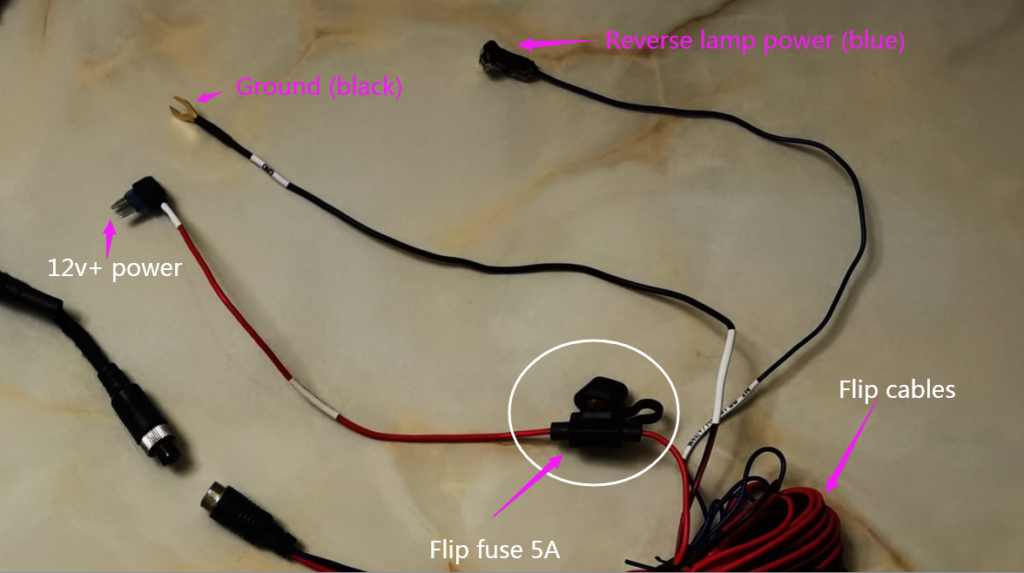

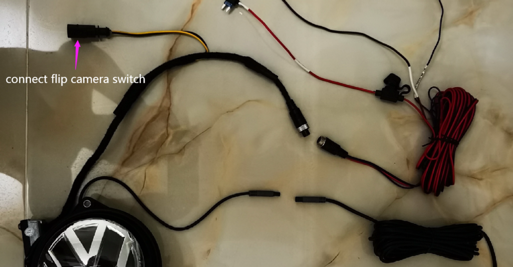

Flip badge camera working principle:
There are two independent systems inside the flip badge camera.-No. 2-5 connections are for the work of the motor of flip badge.
-No. 6-10 connections are for camera work.
No. 3 is connected to the reversing light, which is equivalent to the trigger switch of the relay. Only when it receives power from the reversing light, the flip motor will start to work.

The No.5 blue fuse needs to be powered directly by the battery (it cannot be powered under the control of the car key, otherwise you will not be able to manually flip the Volkswagen badge on the outside of the car to open the trunk).
Look carefully at the insertion of fuse No.5 in the fuse box position.
The ground wire must be in direct contact with the metal body of the car.
The No. 3 alligator clip must be connected the correct OEM plug for the reverse light. If you modified the tail light, you should pay special attention to find the original tail light plug when installing.

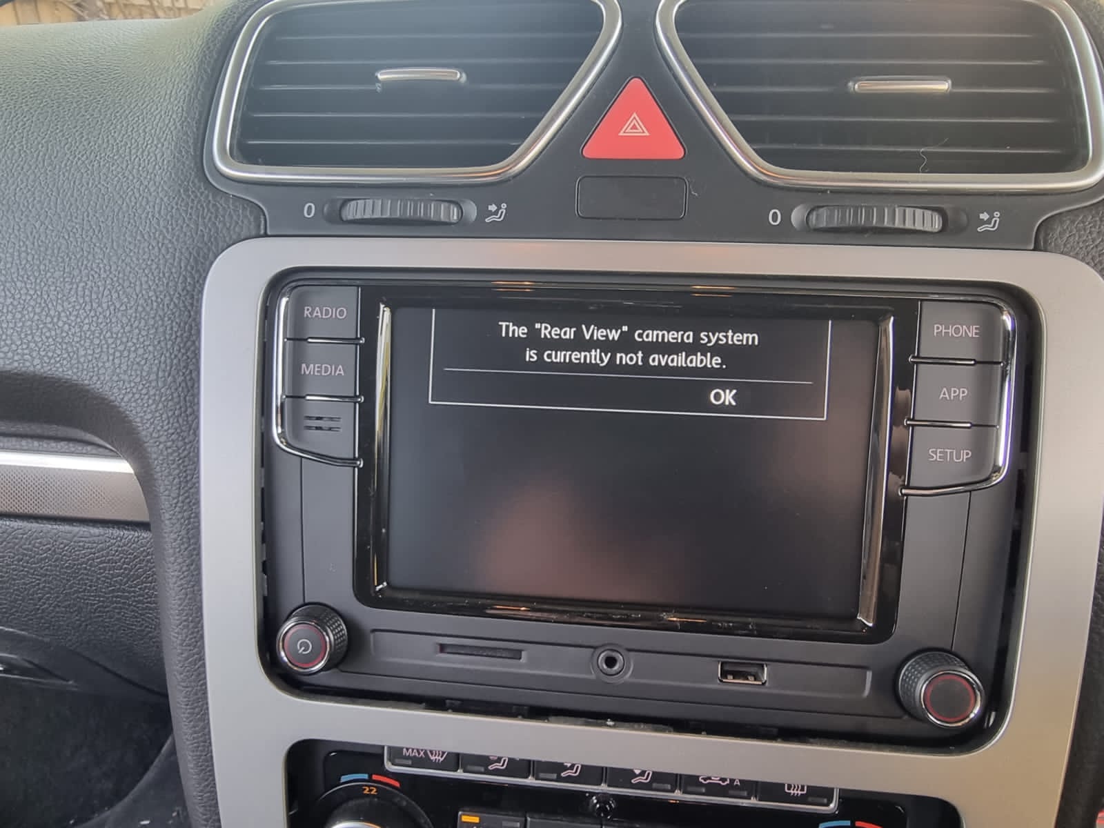

2.The rear view cameras system is currently not avaliable.
The Volkswagen badge can be flipped over when you reversing, but the camera is not available to display the error message on the screen.
If the above error message appears on the screen, it means at least the following two points.
1) The backup camera function of the unit is activated, otherwise the screen will nothing happen when you reversing.
2) Communication between your unit and the gateway is successful.
You need to check No.6-8 and No.10 connections in the picture.
You need to confirm the insertion position of fuse No. 6, and make sure that the tail of the fuse sharer is facing the ground, not the sky. And it must be inserted into the ACC position, that is, controlled by the car key, otherwise the battery will drain.
For the No. 10 blue plug, if your car comes with a blue plug, you can remove the original plug, discard it, and insert the new blue plug into the quadlock in the same position as in the picture.(You need to pay attention to the order of the black wire and the white wire in the blue plug.)
If you want to keep the original blue plug and continue to work, you can do as shown in the video below and move the two pins of the camera into the same position in the original blue plug.
https://youtu.be/QondYFTdLxY
CANBUS+ means CANBUS high,
CANBUS- means CANBUS low.
If the CANBUS connection is upside down or unstable Or the alligator clip No. 9 did not cut skin of the wire and made poor contact, a "No CAN" error text message will appear on the screen, and the dynamic parking line will not work, but usually the reversing image can be displayed normally.

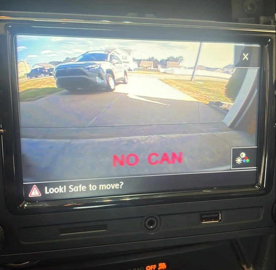

Quote from jaredtschuor on October 12, 2025, 12:24 amThanks, I have the pins switched and it seems to be working, last issue I have is the can, I know where the + & - are on the harness but my new wires are marked can H and can L , the other photos I have seen show can + and can -????
